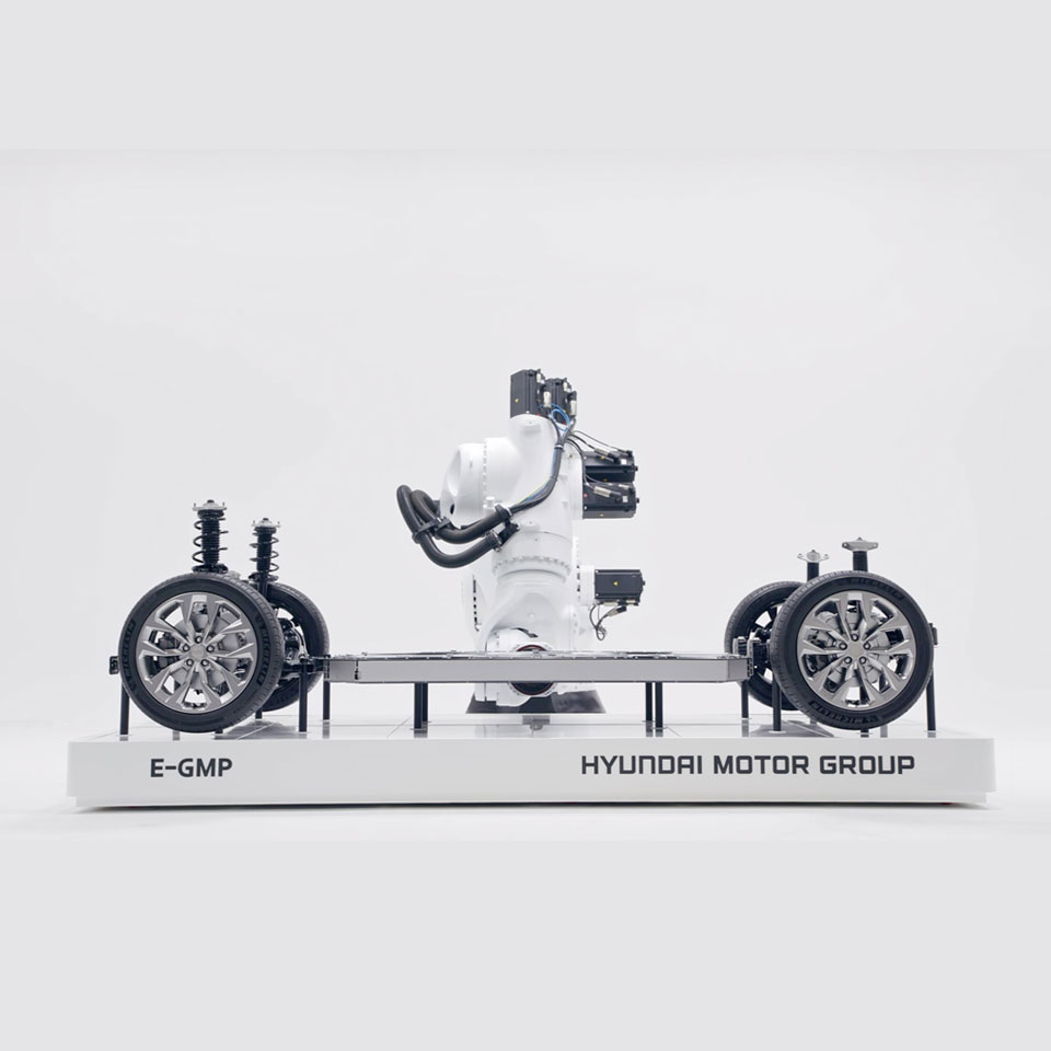

    Zum Thema Abwärme schreibt Hyundai/Kia selber, dass die Abwärme von mehreren Komponenten genutzt wird:
    Zitat
    Hyundai Motor Group’s heat pump system uses not only the heat from the external air but also the waste heat from electronic vehicle components—e.g. the motor, OBC, EPCU/PE Module, battery, and slow charger—to heat the cabin.
    The Crux of Mobility’s Sustainable Future
    The Electric vehicle is the most representative variety of the existing eco-friendly vehicles, because it does not use fossil fuel. With global warming…
    www.hyundaimotorgroup.com
    Und spezifisch EV3:
    Zitat
    "Previously, only one heat source, either external air or the PE system's waste heat, was utilized. However, the next-generation thermal management system of the EV3 allows for more efficient thermal management by simultaneously utilizing both."
    The Kia EV3 Tech Day: Discovering the Exceptional Features of the EV3
    The advanced electrification technologies of the EV3, designed to provide a more convenient electric vehicle experience, were showcased at the ‘Kia EV3 Tech…
    Sicherlich gibt es da dann noch ein Spektrum, wie effizient das gemacht word.
